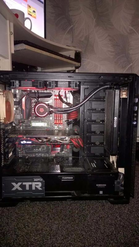

So I won a competition and got a ID-Cooling Auraflow RGB 240MM AIO unit that's going into my lads machine.
It arrived today and I decided to run it in my own system to see how it compared to my Phanteks PH-TC14PE
first impressions of the cooler is its a nice bit of kit. its fairly straight forward to fit and looks good fitted.
so basic system specs are..
4790k @ 4.6Ghz 1.25 vcore
16gb 2400Mhz kingston
Msi 980ti gaming 6g
so first I noticed was the 980ti idled lower I think this is due to not having the big heat sink above it.
I ran heaven just to see how the 980ti would benefit.
CPU temps were identical during the run but the 980ti was 2c lower.
during idle the CPU was between 2c to 3c higher with the 240mm AIO than it was with the phanteks.
I ran realbench for 15 minutes.
this is the AIO
heres the Phanteks
so the Phanteks wins by a few c I know it wasn't a lot but its the difference by being under 80c plus it was quieter..
Its now in my lads system as he was running a stock cooler.

So ive had another play with this in my system..
after seeing a video on youtube where the boy tested an AIO cooler in a few placements he found best results with it fitted to the front of the case used as an intake..
So I decided I would give this a bash. I used the Noctua fans to try and give it a fighting chance.
so what have I found..
Idle the CPU sits around the same as it does with the PH-TC14PE, The GPU sits a few c lower.
load.. the CPU is 1 or 2 c lower and the GPU is a few C lower..
so now the question lies.. is a few c worth the extra noise?
Im used to my system being pretty silent. with the AIO fitted its not.. Plus ive lost my Blu Ray burner.. I cant remember the last time I used it but ive had it there for a while..
