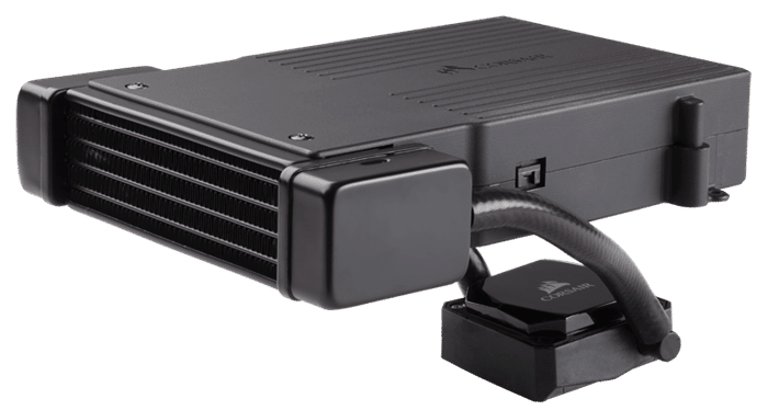

not sure if something like this would fit your case. I saw this when I had an old lenovo with an i3 system but I sold the system.
www.corsair.com/en-gb/hydro-series-h5-sf...le-liquid-cpu-cooler
it says RRP £75 but it can be bought from Scan for £54
www.scan.co.uk/products/corsair-hydro-se...wcF3vg0aAkXPEALw_wcB
it gets a decent review
www.eteknix.com/corsair-hydro-series-h5-...o-cpu-cooler-review/

7 years 9 months ago #10 by Martin
Replied by Martin on topic Skylake i7 6700 - Running too hot?
that's a nice little rad! the problem is the machine uses a proprietary CPU cooler mounting pattern so fitting anything else on it would need some custom work. as the machine is just a stop gap I fear its not worth worrying about!
