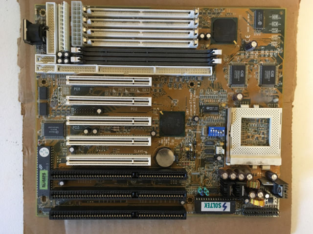

The motherboard is an soltek sl-54p5 socket 7, and it has these jumpers
and switches. any ideas which ones i have to move?
7 years 8 months ago #6 by Nik
Replied by Nik on topic Overclocking a pentium mmx
Yea, there must be a "chart" printed next to the Dip switches and another one next to the jumpers...
Can you take a picture of that charts together with switches/jumpers?
7 years 8 months ago #7 by Poicly
Replied by Poicly on topic Overclocking a pentium mmx
this is the best picture i can find online, when im home i will take Better pictures, i hope this helps!
7 years 8 months ago #8 by Nik
A detailed shot of the charts will help a lot to tell you the settings.
I can see it on the left to the jumpers, but can't read it.
There is another one above the dip switches, this is important, too.

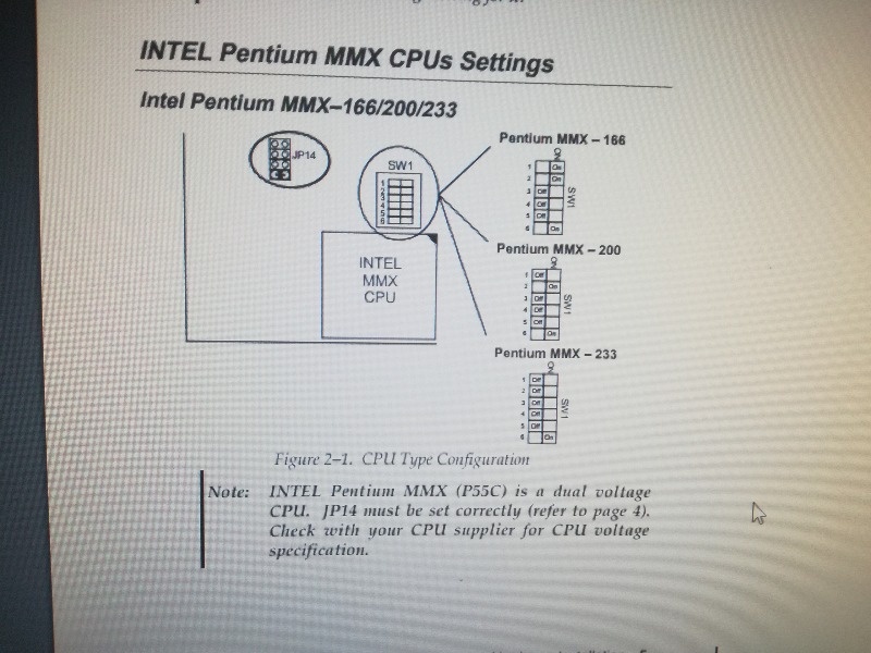

i found the manual for this motherboard. Can you ensure me that this is the correct configuration i need for overclocking my Pentium?
7 years 8 months ago #12 by Nik
Is there another page that shows the settings of the DIP switches? that would be great, too.
7 years 8 months ago #13 by Poicly
no, i don't see anything other than this, i got a page about the jumpers but that's just saying things about the voltage for diffirent processor types, this is the only page about the DIP switches, i tried the 233 switch setup and nothing changed, still at 200 mhz :(
ps: you guy's are lucky that i have so many problems with this computer otherwise there wouldn't be as much activity :P
pps: if you want to look at it yourself here is the link: www.elhvb.com/mobokive/archive/Soltek/Ma...207/sl-54s2/54p5.pdf
7 years 8 months ago - 7 years 8 months ago #14 by Nik
check the JP14 chart on page 4 to assure the correct jumper setting for the VCore voltage plus the chart on page 13 / 14 for the clock setting.
BUT BE CAREFUL!
you might need a bigger fan and fresh thermal paste on it!!!
266 MHz @ 3.5 x 75 MHz are possible
