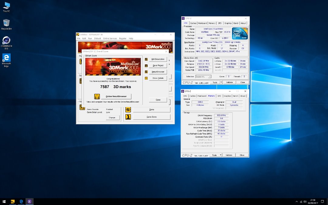

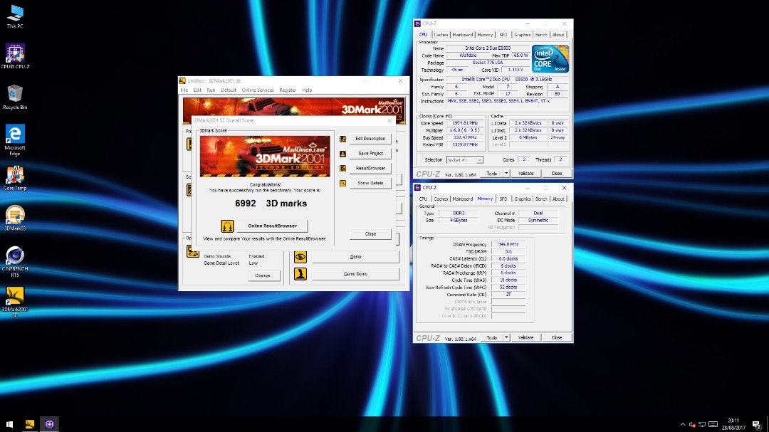

We recently came across an 8000 ELITE which is the model that HP replaced the DC7900 with. They are pretty similar, Both use Socket 775 Processors, Both use the same Intel Q45/Q43 Chipset and on board video.
The main difference is the new 8000 Elite uses DDR3 where the older DC7900 uses DDR2.... So this got us thinking, Running the exact same CPU, and the same 4GB of ram (2x2GB Dual channel) just DDR2 VS DDR3, what sort of performance gain, if any could be had?
The video is going live soon on the channel when its finished, after the machine has had a makeover, but thought I would give you guys a sneak peak.
so who wants to take a guess... will we see a gain going to DDR3? if so care to take a guess at how much extra performance.
The benchmark tools are simple, Cinebench R15, 3d Mark 2001se and CPU-Z benchmark.

3d mark 2001se on the DC7900 scored 6992
3d mark 2001se on the ELITE 8000 scored 7587
If my maths is correct I make that at an 8.5% gain in performance just from switching over DDR3 memory. Its not life changing but when both machines cost roughly the same, it makes the 8000 a good buy!
