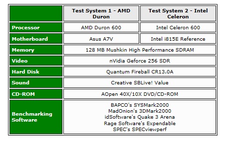

Test Setup
Die sizes and cache structures all look good on paper, but the only real indicator of a processor’s potential is performance (and price).
In our benchmarks, we’ve shown the Celeron using a 66 MHz FSB and 100 MHz memory clock, which represents a more realistic environment, as most new systems (133A, i815) are capable of asynchronous memory operation, and feature PC100 memory at least.
We’ve also shown the Duron using a 100 and 133 MHz memory clock. If purchasing from an OEM, the most common configuration would be with PC100 memory, which is why we’ve opted to show 100 MHz memory benchmarks. However, those building on their own will have the option of slightly more expensive PC133 SDRAM, and since the KT133 is fully capable of asynchronous memory operation, we thought it best to include those, too.

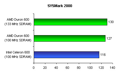

Performance - SYSMark & 3DMark
In SYSMark2000, our business application test, the Duron outpaces the Celeron by a significant margin, almost 10%, and even more when paired with PC133 memory.

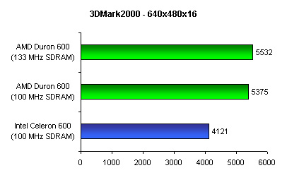

3DMark2000 paints a similar picture, with the Duron pulling ahead by a greater margin with PC133 memory.

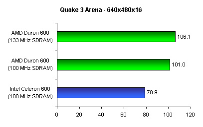

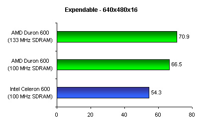

Performance - OpenGL & Direct3D
It doesn't take a PhD to understand these graphs--for a gaming platform, the Duron is the better option, without doubt.

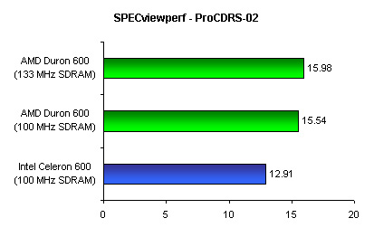

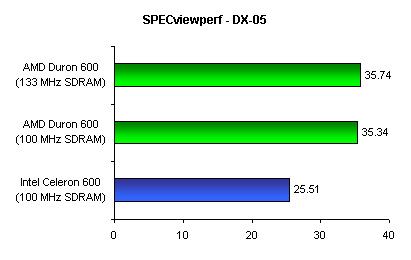

Performance - Professional

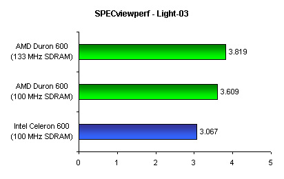

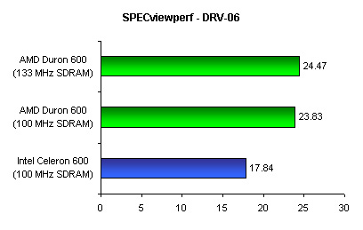

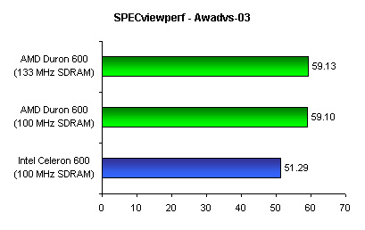

The Duron, based on the more-powerful Athlon core, shows superior professional level performance. While neither of these processors would be the first choice for a professional environment, the Duron is certainly the better of the two.
Performance Analysis
The graphs really speak for themselves in this case: at default clock speeds, the Duron is clearly faster than the Celeron in all circumstances. Not marginally faster, but significantly faster, around 25% plus in most cases. When paired with common 2-2-2 PC100 memory, the Duron has no trouble soundly trouncing the Celeron, and when coupled with the somewhat rarer (and more expensive) 2-2-2 PC133 memory, it pulls even farther ahead.
