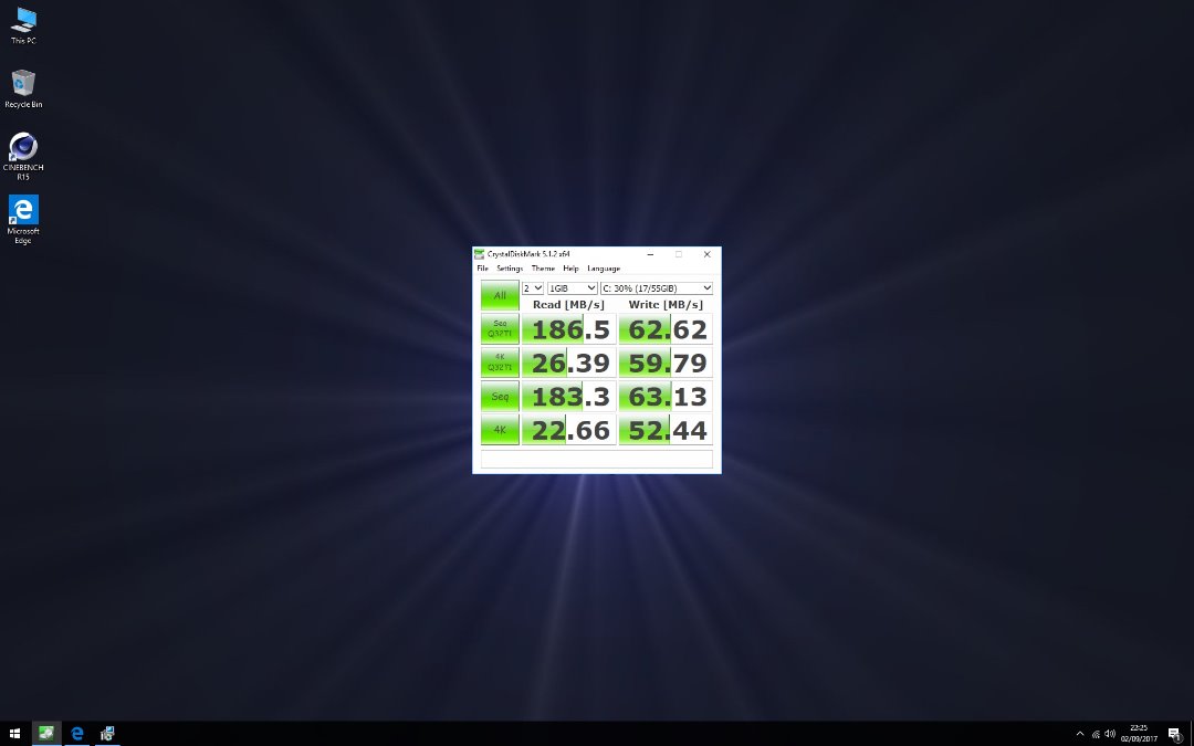

So here's an interesting one ive come across over the last few years of using SSD's - Performance degrading over time, ive noticed this where my drives dont quite hit the blistering speeds they used to or the manufacturer advertised speeds.

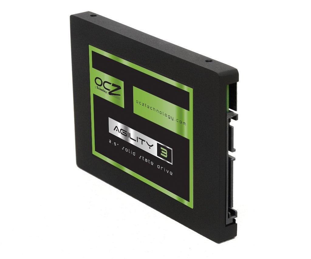

So todays candidate is an OCZ Agility 3 60GB in my HP Elite 8000. Now I had one of these drives when new a few years ago, although a 120GB one and the performance was blistering. OCZ advertise 525MB/s Read and 500MB/s Write and the drive always delivered.
So, go back a few days I had just got the machine installed and running properly with drivers, windows updates etc and I thought I would run a benchmark to update our benchmark thread, surprisingly the drive wasn't performing anywhere near as it should...

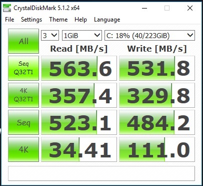

My OCZ Trion 150 is supposed to do 550 Read /520 Write...
I agree with you though, in general most get close but not always advertised figures!
7 years 8 months ago #4 by Nik
Using Crystal Disk info will show the actual Performance of your SSD...
The small 64gb Crucial in my main machine has degraded, too.
It's now at 98%...
