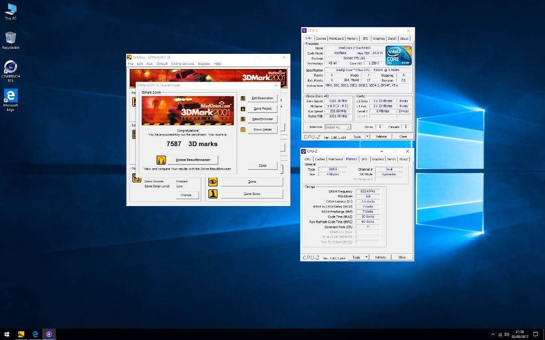

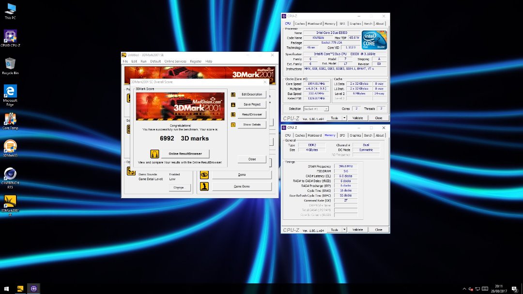

3d mark 2001se on the DC7900 scored 6992
3d mark 2001se on the ELITE 8000 scored 7587
If my maths is correct I make that at an 8.5% gain in performance just from switching over DDR3 memory. Its not life changing but when both machines cost roughly the same, it makes the 8000 a good buy!
