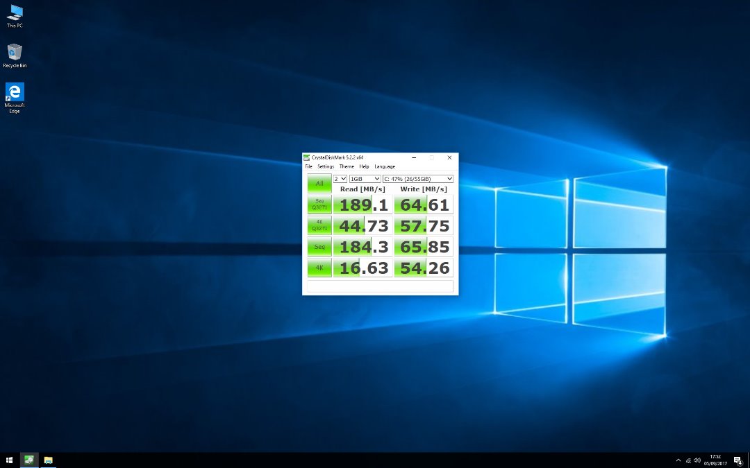

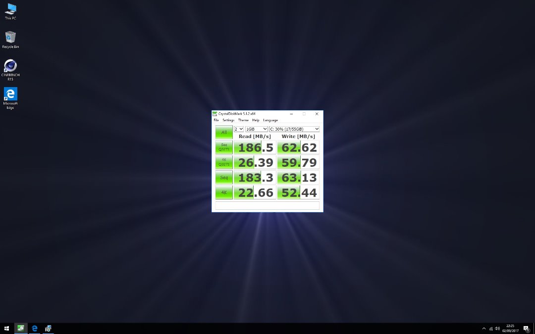

So, go back a few days I had just got the machine installed and running properly with drivers, windows updates etc and I thought I would run a benchmark to update our benchmark thread, surprisingly the drive wasn't performing anywhere near as it should...

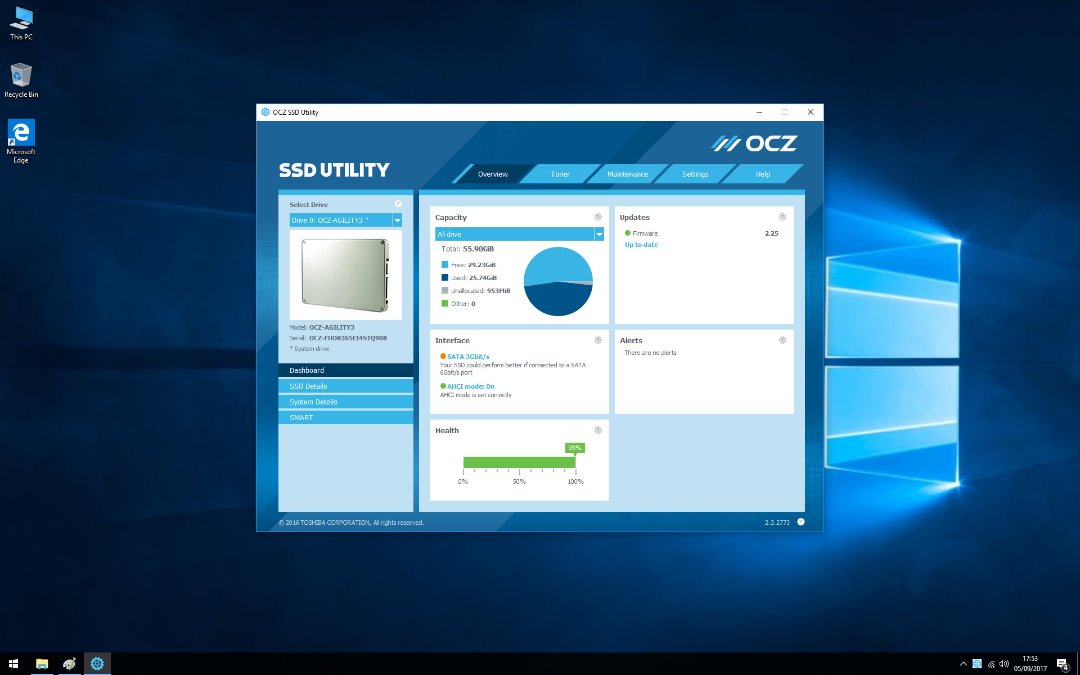

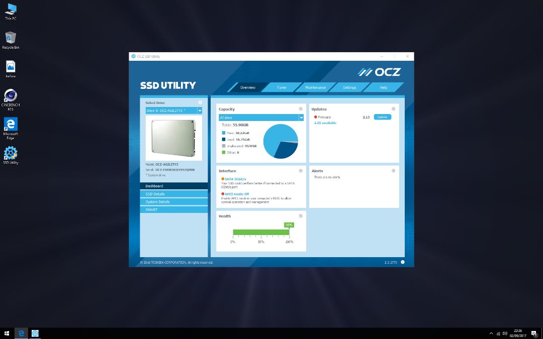

My first thought was lets get the OCZ software installed and see if there is a firmware update...
As expected the drive was on v2.13 of the Firmware and v2.25 was available. ALSO AHCI wasn't enabled by default in the bios of the HP for some reason!
I used the OCZ utility to make a bootable firmware update USB Flash drive and booted to it, updating the firmware. Ran a quick test and it was no different. As is commonly the case, enabling AHCI doesn't allow the machine to boot into windows after its already been installed. There may be a workaround for that, but as I hadn't installed any software yet I popped in the Windows DVD and just done a fresh install again, windows updates all completed, drivers all installed ran the tool again to make sure all was as it should!
AHCI was enabled, latest firmware applied, and also the HP was on the latest BIOS v1.14 (14/10/2015)...
Again much the same, slightly better in some areas, worse off in others.

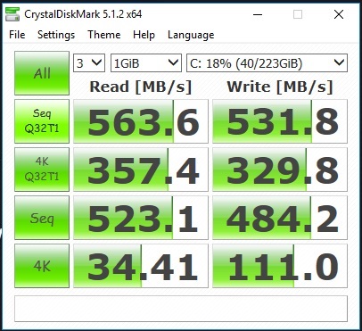

My OCZ Trion 150 is supposed to do 550 Read /520 Write...
I agree with you though, in general most get close but not always advertised figures!
